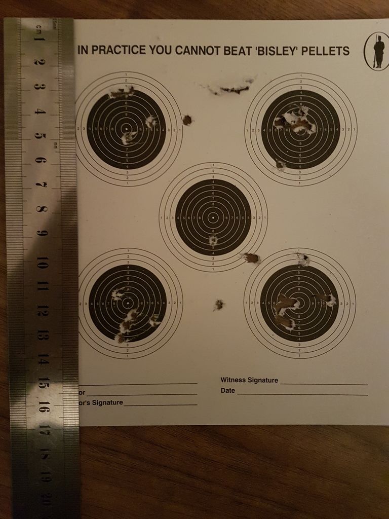

I only really put one target up that and here it is:
The centre target was as I was beginning to zero the scope for 30 yards.
Top-left and bottom-right were after a little fine-tuning.
Bottom-left after a little more and, finally, top-right after I felt I was about there.

Great to hear it went well with the new scope Blerk, and that Brian was happy with the accuracy of your kit.
The top-right zero target is pretty decent, maybe a click or two high, but a tight group at the aimpoint, also the L-R looks spot-on. ;)
So, if you and Brian are happy with the set-up, the only thing left to do now is practice practice practice, then practice some more, even if it's at shorter range in the garden if you can manage it, or even just practicing a consistent hold and trigger release (without actually shooting) when indoors. Don't forget, consistent repetition is the key to accurate springer shooting. ;)
