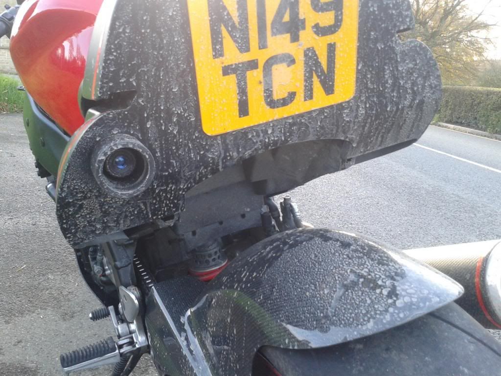

Great idea but a possible problem, if you take it out in wet weather that is, will the position of the camera be in a vacuum/vortex and get coverd in the crud off the roads kicked up by the rear tyre?

It only ever goes out in the wet Uggy if I've gone somewhere in the dry and then it's rained.
I have also put the camera itself into a baffle tube which will protect it from the majority of turbulence.
If I still get debris causing a problem, I'm in the middle of making an external cover lens which encloses the whole thing and can just be wiped clean.

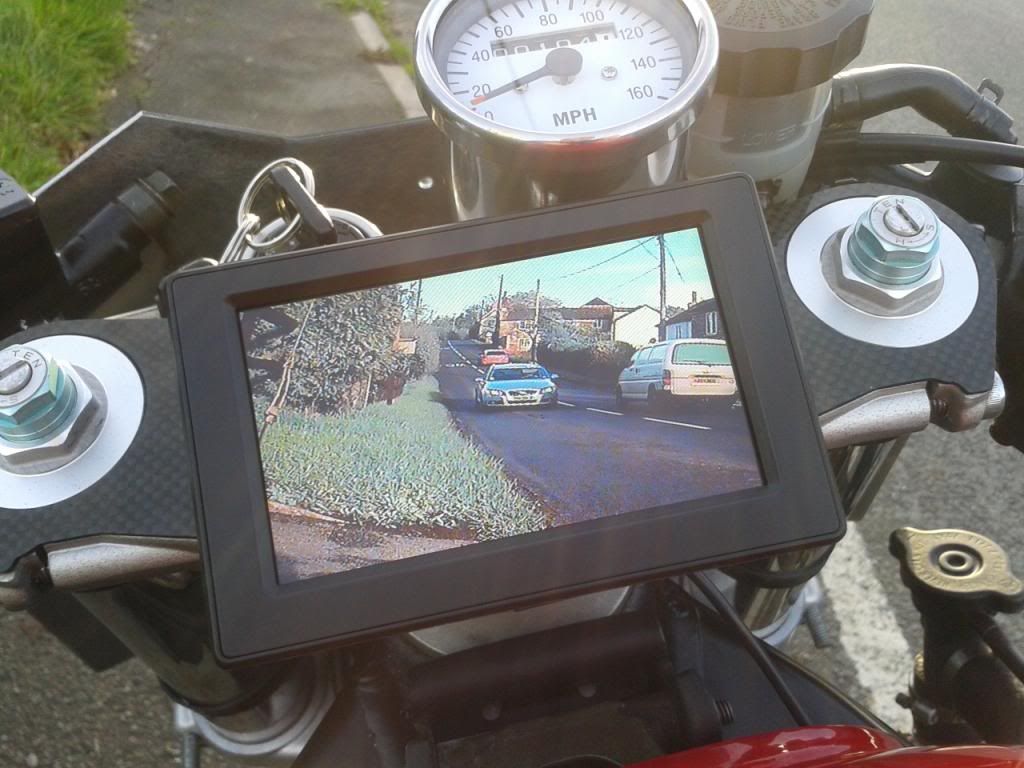

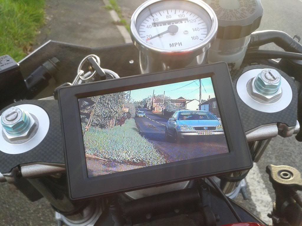

Here we go, better lighting for these shots.
Firstly I went out without a cover on the camera to see if the baffle works, which it does, but I'm making the secondary cover all the same.
So, this is how dirty the back of the bike was after a damn good hoon:
And these are images from the camera after said hoon:
As you can see, the images are of very good quality, funnily enough, the same quality as the Hunter NV unit.
I've also mirrored the image so it is ass you would see when using a physical mirror.
Only problem is, I'm going into corners and spending all my attention on what lean angle I've got by looking at the screen, rather than concentrating on the road!
