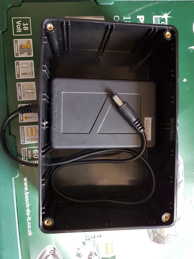

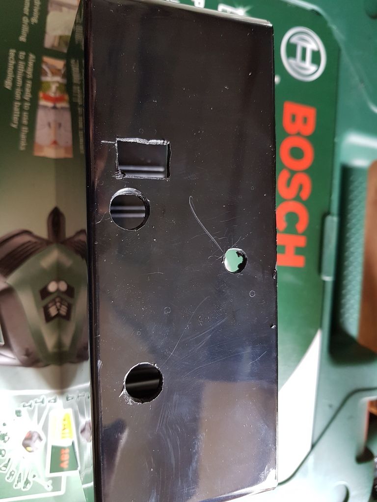

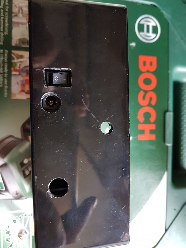

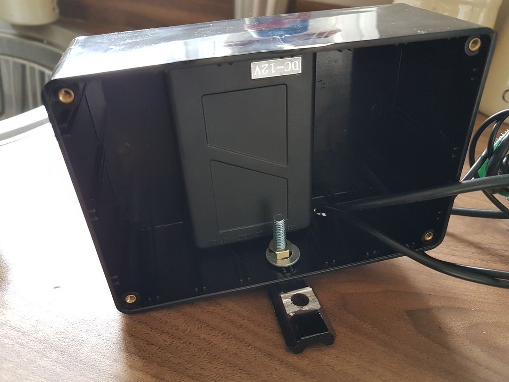

  • Time to start work on the project box so put the battery in there and mark out ON THE BOTTOM OF THE BOX where the switch and power socket will be. Also mark where the bolt will go to attach the box to the rail AND where a second hole will go to pass the power cable back into the box.
    Here's a pic of what mine looked like (the second time I did it because I learnt from my mistakes with the first project box):
    The bolt hole is the smaller one on the right.
    Here it is with the battery in place:
    And here another view with the battery and power cable in place:

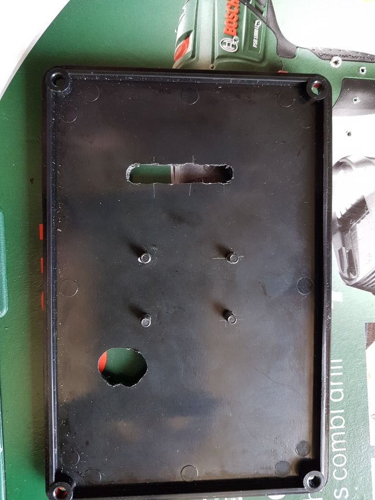

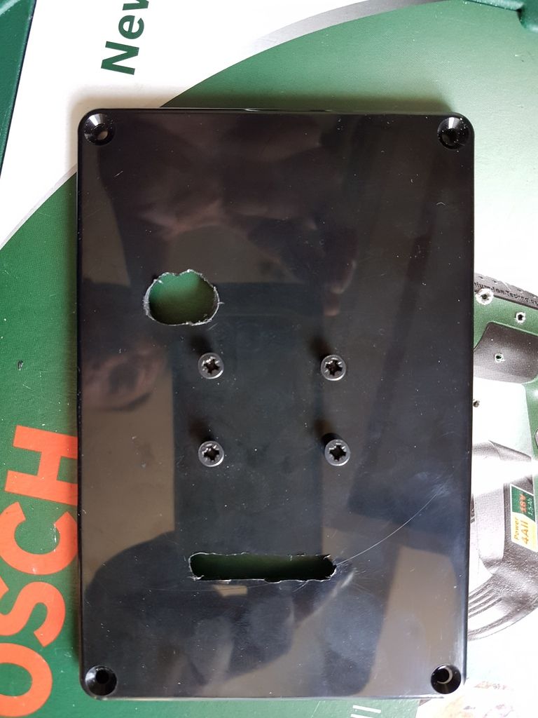

  • One of the design requirements was that it could ALL be dismantled and all components replaced if anything breaks. One issue I had to overcome was how to afix the screen to the project box. One suggestion was glue. I nearly went that way (again, I refer to the demise of the first project box) but a mate suggested four little screws to make posts onto which the screen would attach as it would attach to its supplied stand.
    So I found four small screws (Yay! The discarded first project box has not been completely wasted!) and widened the holes in the back of the screen EVER SO SLIGHTLY and used a template to transcribe their position onto the removable front of the box.
    Also use the template to mark out the position of the screen cable and the menu buttons.
  • Drill where the template indicates. Big holes for cable and buttons, tiny pilot holes for the screws.
  • Screw the screws in (not too much, not too little, but just right to hand the screen securely).
    Here's a pic:
    And another from the inside side:

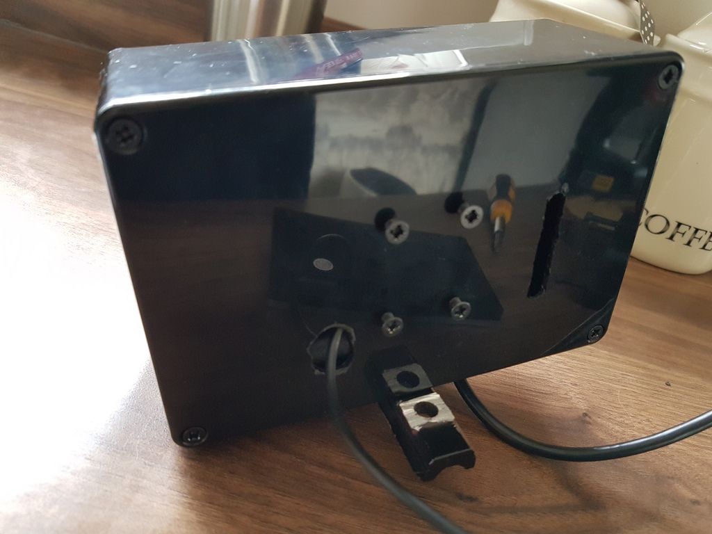

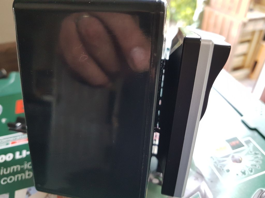

  • Thread the screen cables through the hole and hang the screen on the screws.
    Pic time!
    (Yes, it's upside down but gives a monkey's?)
    Here's another (they're coming faster than buses!):
  • With the battery in place, bolt the box onto the rail.
    You'll notice that I have removed part of the mount (because it was getting in the way). You may need to make small mod's like this yourself depending on your mounts, rails, scope, preferred positioning (oo-er!).

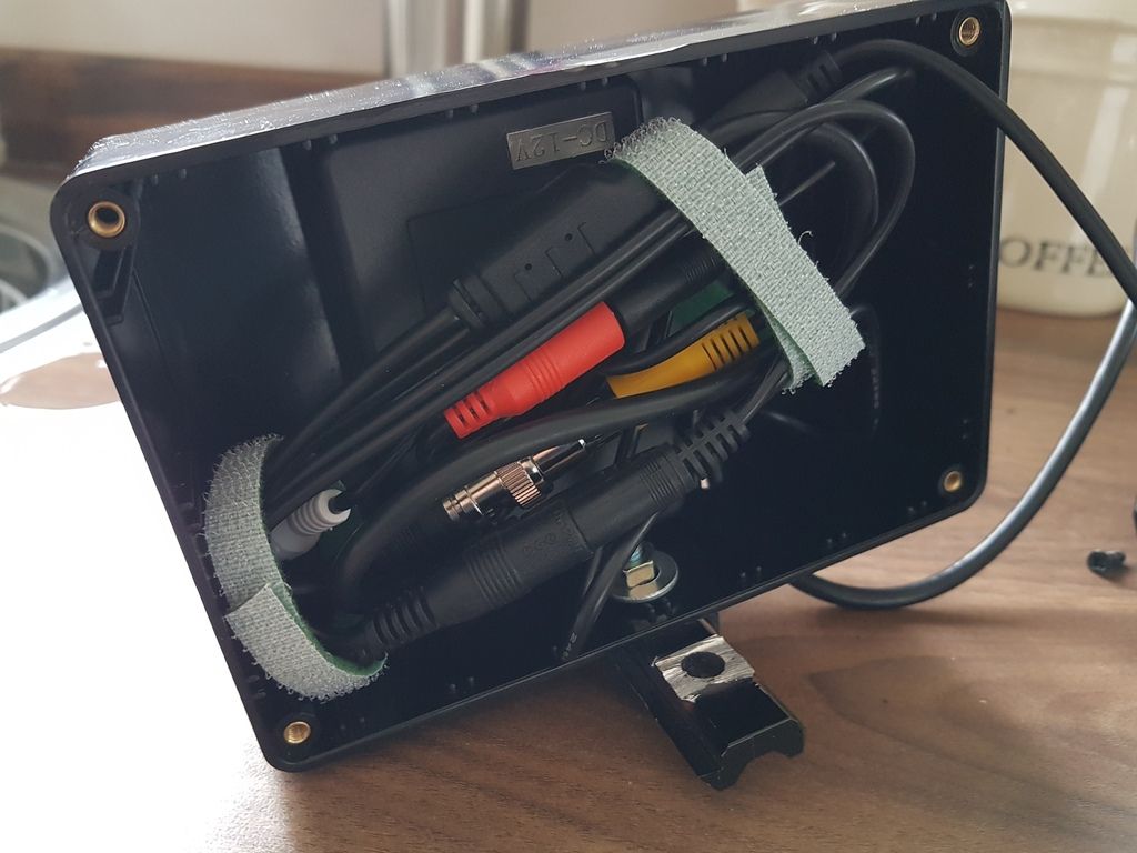

  • Connect all your cables.
  • Switch the battery on and make sure you have a picture on the screen.
  • If all is OK use some Velcro to tidy things up.
    We haven't had one for a while so here's a pic:
    You'll notice that there's a cable (top right of pic) that looks as if it's going to get in the way but it's not; that's the cable running from the screen through the box lid so it's actually inside the box.

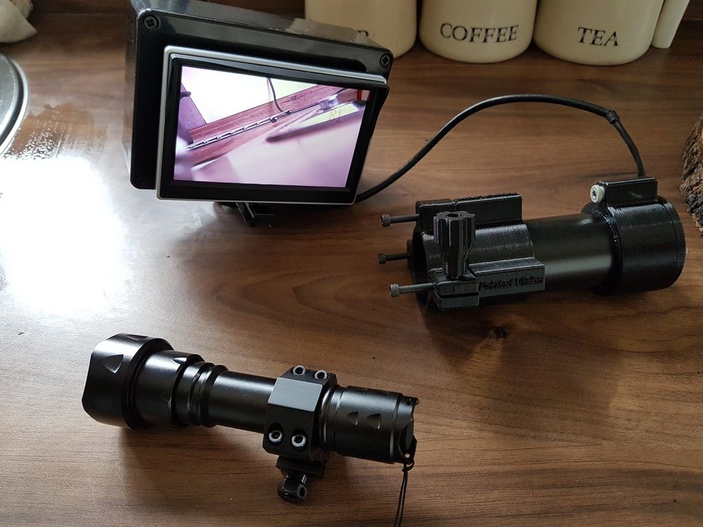

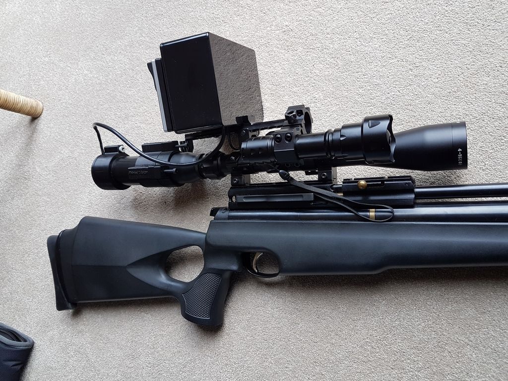

    (Do you know what you've got in front of you now? Yes, a fully funtional, tidy, modular NV rig.
    Here's a pic to prove it:
    Seriously, all you have to do now is mount it on your scope.)

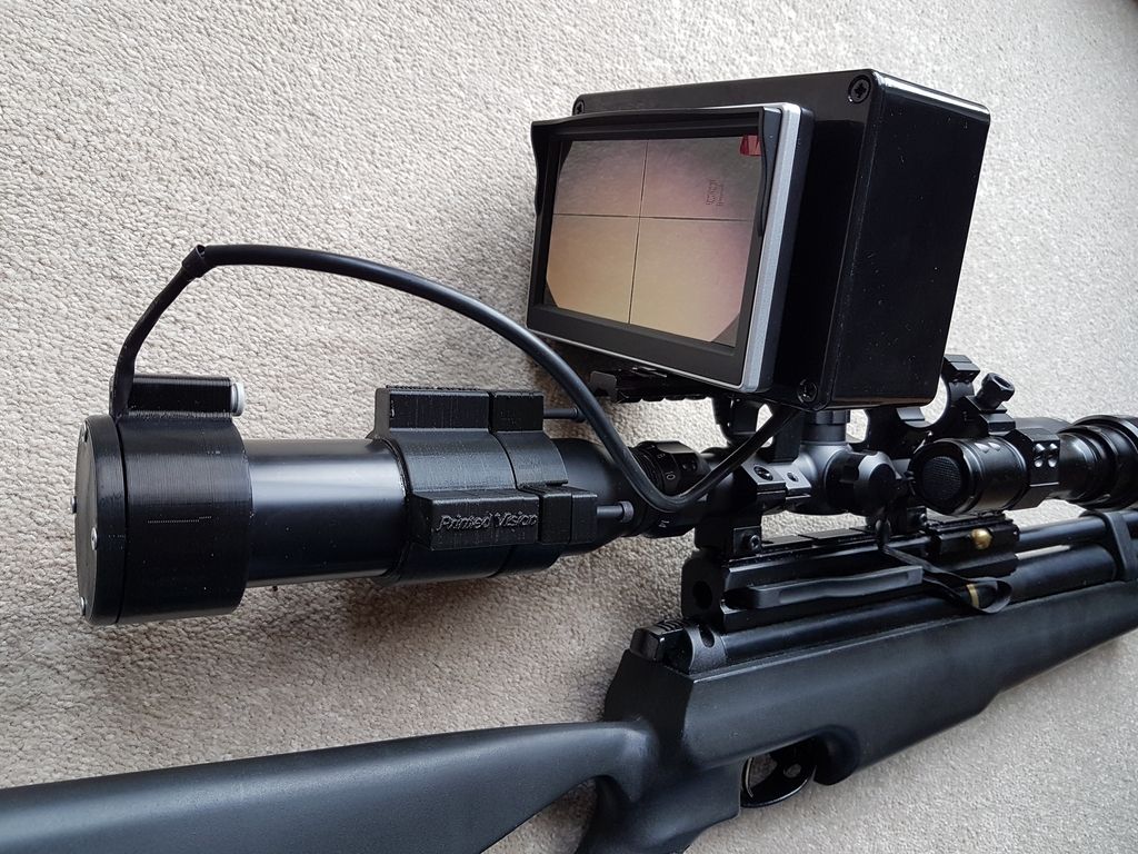

  • Attach the high mounts to the scope. Your rails and personal preference will dictate where you do this.
  • Attach the torch mount to the scope. Your rails and personal preference will dictate where you do this.
  • Attach the box rail to the high mounts.
  • Attach the camera mount to the eyebell of the scope. You may need to fiddle a little to get the crosshair central in the screen.
  • Attach the torch to the torch mount.
  • Sit back and wait for darkness.
    And while you're doing that, admire the wonderous piece of kit you've added to your arsenal:

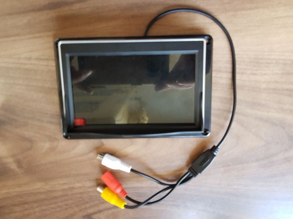

  • I selected the screen over other "reversing displays" because it DOESN'T have red/yellow/green hatching on the display to aid maneuvering.
